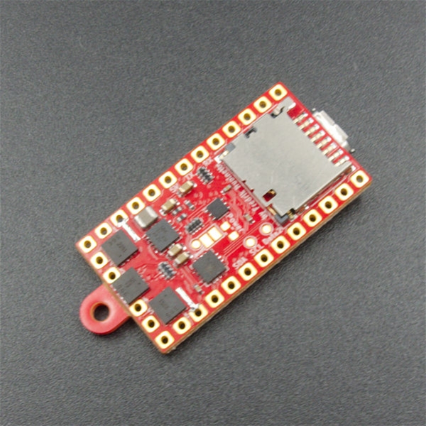

Proffieboard v3.9 Soundcard - Red with tab
Retail Price: $65.55
Price: $48.99
  • SKUPROFF39RWT
Need 10 or more boards? Contact us for wholesale pricing!
This version has a break away mounting tab. You can use it to mount the board to a chassis or easily remove it if not needed.
Screw for tab can be found here
The latest fully open source Saber soundcard with Smoothswing and Pixel capability! An advanced board with a tremendous amount of customization options.
Preloaded default sound package is installed on the included Sandisk Ultra Micro SD Card
  • 80Mhz ARM processor
  • 160kb RAM
  • 512kb Flash
  • 3 button pads (capacitive touch capable)
  • 4 neopixel data pads
  • 3 use for anything pads (These can either be used to drive 20mA LEDs directly, or as neopixel data pads, button pads or servos)
  • 3 serial ports
  • 3 i2c ports
  • 2 SPI ports
  • 6 FETs
  • 6-axis motion chip
  • 3-watt amplifier (mono)
  • S/PDIF or I2S output
  • 450mA USB charging
  • SDIO sd card reader
  • onboard status LED
  • center-board pads for: USB, SWDIO and additional 3.3v capacitor
